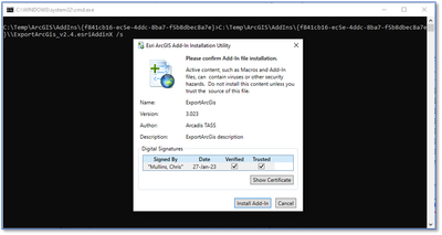

We need to install of ArcGIS Pro Add-In silently and I found this page : https://gis.stackexchange.com/questions/309009/silent-install-of-arcgis-pro-add-in
I added the registry key
Added subfolder with AddInInfo id as name.
The .esriAddInx is digitally signed .
Try to run the installation silently, but it’s still asking for user interaction.
What am I doing wrong?
Kind regards,
Steven
GKmieliauskas
Hi,
There is no need to install ArcGIS Pro addin if you add addin path to registry. Installation puts your addin to Documents\ArcGIS\AddIns\ArcGISPro catalog. This is default folder for addins. It could be matter in which registry part you add the folder: local machine or current user.
