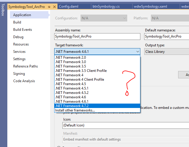

Yes, that is the problem.  But I for sure have 4.8 installed on my desktop, yet it does not show in Visual Studio.  Can you assist??

OK.  It looked like problem was that while 4.8 was installed, what i also needed was the 4.8 Developer Pack from here installed:  Download .NET Framework 4.8 Developer Pack Offline Installer
I have read that I may also need to update the 'desktopVersion' in my Config.daml, yet everything does seem to work when I don't do that.
