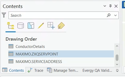

Hi -
I'm just trying to understand what's going on here.   I have a stand-alone table from an Oracle database in my TOC named MAXIMO.ZXQSERVPOINT.   See below.

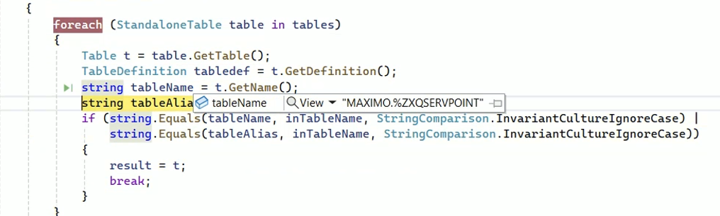

When, in code, I iterate through the tables present in the TOC the name is returned as "MAXIMO.%ZXQSERVPOINT".   See below.
What's the deal with the "%" ??

EdwardBlair
NM.  I should have Googled before posting.   Apparently this is an ArcPro SDK convention that indicates the table is defined with traditional versioning.
