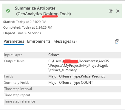

Second thing I noticed was that using the toolname "geoanalytics.SummarizeAttributes" I actually got a _server_ flavor of the tool and not the _desktop_ flavor (not that I knew there were two as I am not personally familiar with the Geoanalytics toolbox).
I wonder if you have a similar issue and are invoking the Geoanalytics server tool and not the desktop tool?
Well, eventually, I ended up with a toolname of "gapro.SummarizeAttributes" which seemed to do the trick and invoke the desktop toolbox. You can try my code below. (I am using the "Interacting with Maps.gdb\Crimes" dataset from the pro community sample data fyi).

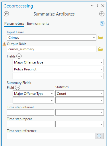

     //Or open the dialog
     //Geoprocessing.OpenToolDialog(sum_tool_name, sum_params);
Gives:
This is the tool dialog invoked via Geoprocessing.OpenToolDialog

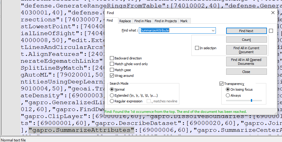

Note: To resolve the toolname I had to look in the GP tool cache to see what it (GP) was looking for. You can find that here: C:\Users\your_username\AppData\Local\ESRI\Local Caches. Despite their rather intimidating appearance they are just text files. Just drag and drop one of them into notepad. I searched for "SummarizeAttributes" and came up with two hits: "geoanalytics.SummarizeAttributes" and "gapro.SummarizeAttributes". As I had already tried "geoanalytics.SummarizeAttributes", I went with the other one.
Gives:
