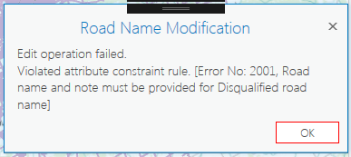

I received an error back that the EditOperation failed due to failing on an Attribute Constraint for another Subtype. It seems after load the Inspector hangs on to the default Subtype, even if it is changed in the Inspector.
Disqualified Subtype Attribute Rule Message

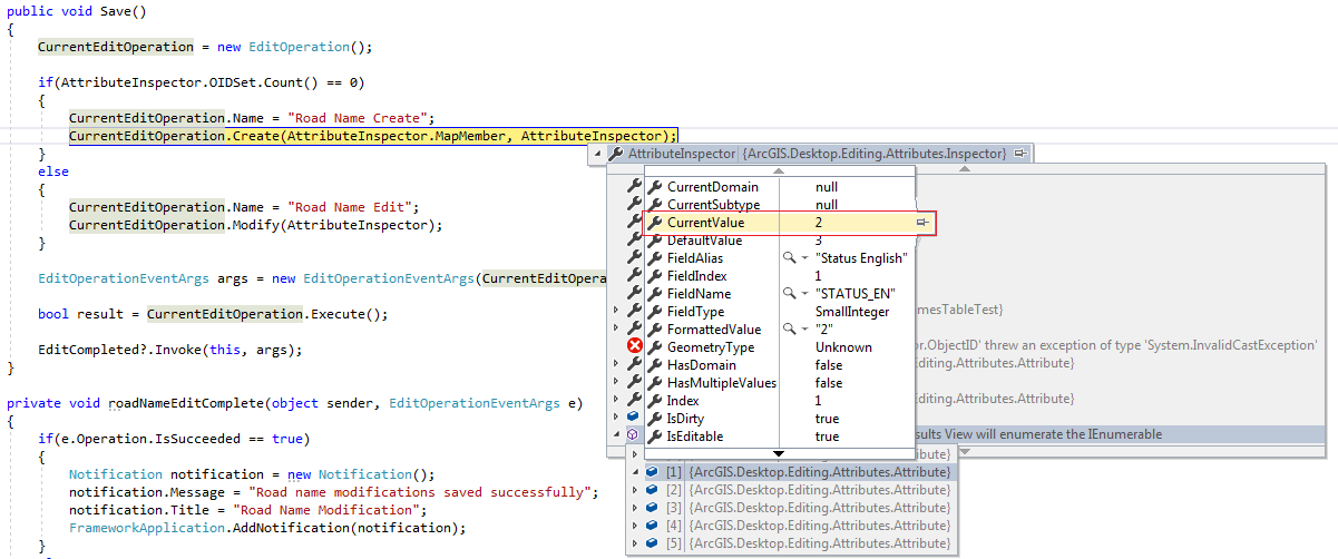

In the debugger, the Attribute for the Subtype shows the Subtype code for Available:
Debugger shows Subtype updated

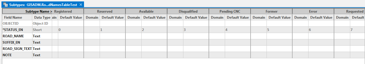

And here is the Subtype definitions:
Subtype Definitions
