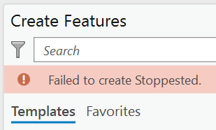

When I run the code it's stepping through and the geoDatabase and the table variables are filled with the correct values. The table is where I want to create a new row. I also made sure the feature class and table is editable. I then create a dictionary with one attribute and value, since none of the fields are mandatory, meaning they are all nullable. My code passes through without errors or exceptions. After that ArcGIS Pro shows me this:

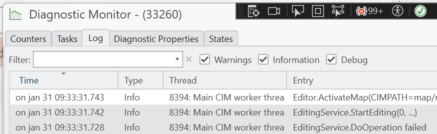

The feature is not created and no new row is created in the table. I turned on the Diagnostics Monitor, and this is what I see
I'm stuck so any help is greatly appreciated 🙂
