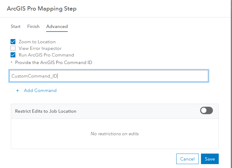

We have a custom ArcGIS Pro Command (addin) in a Workflow Manager Server step not working.
How could we debug or see whatever logs?

The point is we cannot hit the breakpoint. An addin in not called at all.
We might be missing some setting when designing our workflow step and our addin.

I am having a similar issue.
Using the Open Pro Items step under Pro 3.2 Enterprise 11.2 I attempt to run a custom Pro command.
The Open Pro Open step works fine, opening a map, but the command is not run: nothing happens.
I know the add-in command works. I can run it from the ribbon.
The Add-In command is a button with a On Click to trigger its action.
Is there some restriction on the type of commands that can be run?
