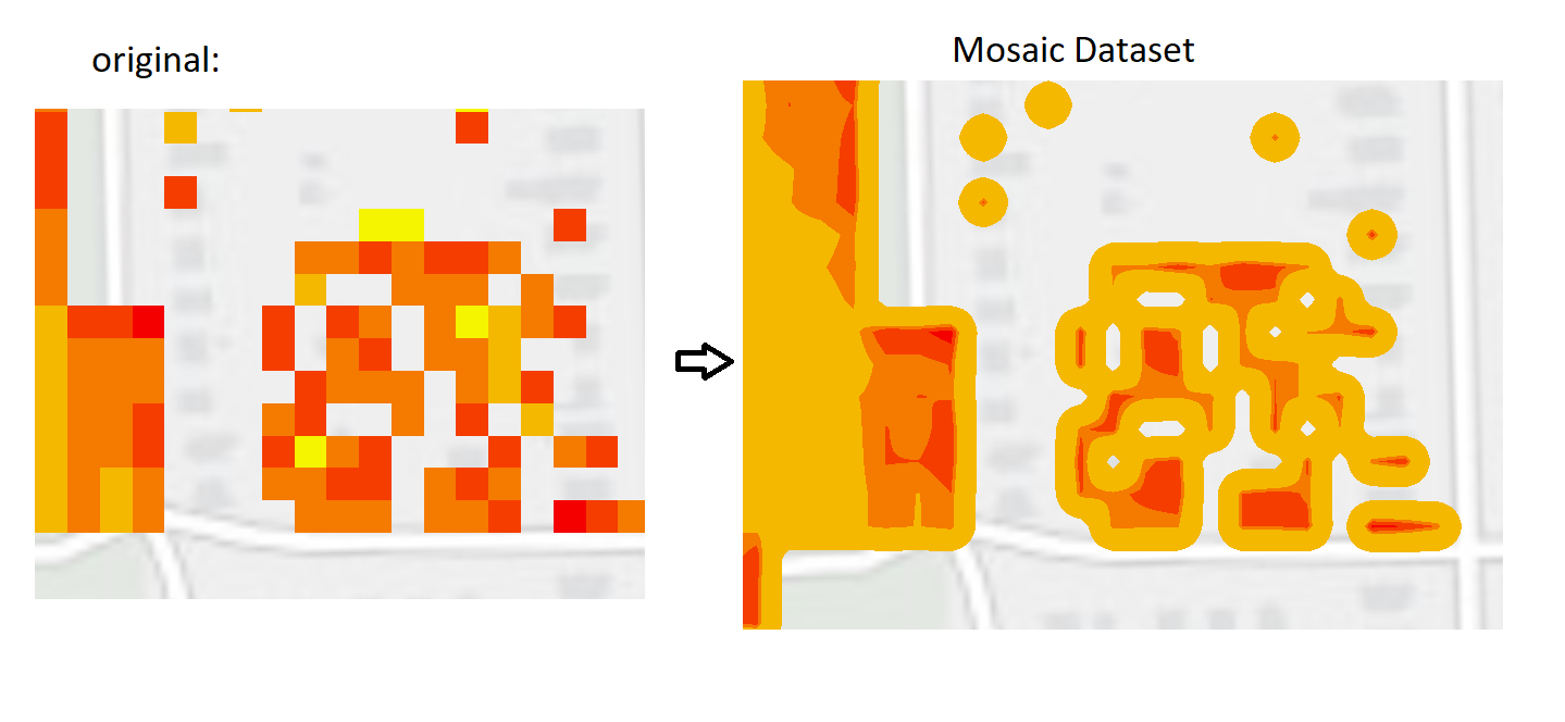

I'm trying to create an animation of several of my raster datasets by creating a Mosaic Dataset and adding my rasters to that dataset and then adding a time field so I can animate through each.  The problem I'm having is that the rasters seem to have some kind of smoothing or outline around each of the cells:
Any idea how this is happening?  Or is there another suggestion for animating between different raster datasets?

Joe,
Click on the mosaic layer in the Contents pane then click on Appearance tab->Resampling Type dropdown. Change the resampling type to Nearest Neighbor and this should produce the same results as the original.

JoeMadrigal
Ah yes!  Thanks!  That is what I was looking for.
