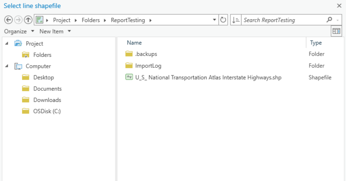

UmaHarano
Hi Alex,
Can you try using the AddMustNotBeTypeId method to pass in the typeIDs to not display?
BrowseProjectFilter browseFilter = BrowseProjectFilter.GetFilter("esri_browseDialogFilters_shapefiles");
browseFilter.AddCanBeTypeId("shapefile_general");
browseFilter.AddCanBeTypeId("shapefile_line");
browseFilter.AddMustNotBeTypeId("shapefile_point");
//Add other typeIDs of shape files to not show.
Also, this is how my dialog looks (below). I have a file GDB in this location. I don't see it nor am I able to browse into it.  So not sure what is happening there.
