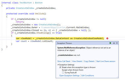

succip
Hello, thanks for your help, but I'm getting an error. once code enters the if statement, _createlotwindow becomes null. I assume this is because I'm setting _createlotwindow.Closed to make the object null on close. It works fine if I set the DataContext before the ShowDialog(). Is there any harm in doing that?
protected override void OnClick()
            if (_createlotwindow != null)
                return;
            _createlotwindow = new CreateLotWindow();
            _createlotwindow.Owner = FrameworkApplication.Current.MainWindow;
            var viewModel = _createlotwindow.DataContext as CreateLotWindowViewModel;
            _createlotwindow.Closed += (o, e) => { _createlotwindow = null; };
            if (_createlotwindow.ShowDialog() == true)
                var count = viewModel.LotCount;
