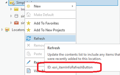

FredericPoliart_EsriAU
Hi
You may be able to invoke esri_itemInfoRefreshButton manually,  but you would have to specify which folder.   There could also be an "invalidate" command, which would force your Catalog to refresh/reload the newly added folders.
The following sample has similar  FrameworkApplication.GetPlugInWrapper() commands:
https://github.com/Esri/arcgis-pro-sdk-community-samples/tree/master/Framework/HookProCommands
but I agree, you would need to specify which sub-folder you are targeting (for the refresh)
