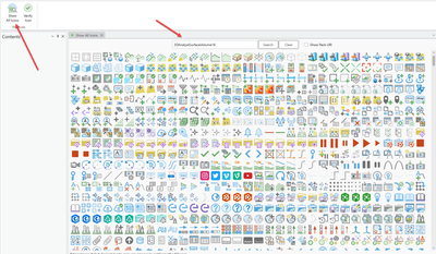

UmaHarano
Here is the update on this issue.
At 3.4, the ribbon buttons are not properly stretching the image when using a small icon (16x16) in a place requested for a large icon (32 x 32). The ImageSource does not stretch to fill the space.
As a workaround, two images can be provided in the addin - for smallimage and largeImage daml attributes.
ArcGIS Pro comes with many out of the box images. This community sample allows you to see the entire list:  https://github.com/Esri/arcgis-pro-sdk-community-samples/tree/master/Framework/ProIcons
If you use the available ProIcons, you can simply copy the icon name (in the image below) and use it in the daml.  Almost all icons will have the 16 and 32 sizes. Note: this image below is available if you use the community sample referenced above.
