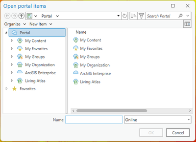

GKmieliauskas
Hi,
Try code below:
            BrowseProjectFilter bdf = new BrowseProjectFilter();
            bdf.Name = "Online";
            bdf.Excludes.Add(@"project_browse_place_project");
            bdf.Excludes.Add(@"esri_browsePlaces_Computer");
            OpenItemDialog itemDlg = new OpenItemDialog
                Title = "Open portal items",
                MultiSelect = false,
                BrowseFilter = bdf
            bool? ok = itemDlg.ShowDialog();
