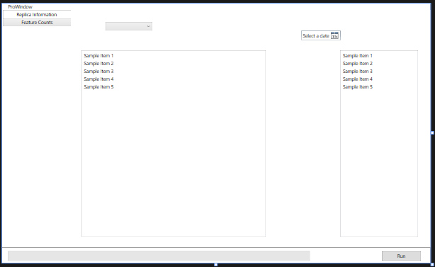

Hello,
This issue seems trivial, so hopefully I'm just overlooking something simple. I had a standalone CoreHost WPF application that would open at the intended height/width of 650/1100.  I am attempting to recreate a similar template layout within a ProWindow, using much of the exact syntax from the other app.  The XAML view within Visual Studio looks correct and matches what I had within the CoreHost app, but when I launch the add-in within Pro, the ProWindow no longer matches. Anybody have any idea what's causing this?
How the app looks within Visual Studio 2022 (with Pro 3.1.1 installed, running latest 3.1.0.41833 Pro SDK version):

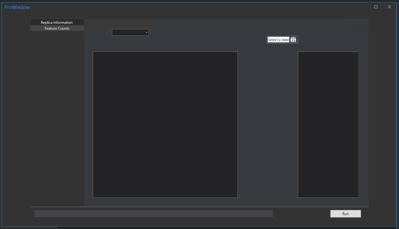

How it looks when launched within ArcGIS Pro:
Here's my XAML code:

mhudson
Curious if you ever got the UI to respond how you wanted it to? I'm running into a similar situation with my ProWindow at 3.1.3 where the width and height do not seem to be coming over when debugging the XAML.
DanNarsavage_IDWR
The `SizeToContent` property (Microsoft doc) may suffice for your needs at ArcGIS Pro 3.2.
<controls:ProWindow x:Class="My.Big.Namespace.MyProWindow"
        xmlns="http://schemas.microsoft.com/winfx/2006/xaml/presentation"
        SizeToContent="WidthAndHeight"
BrianBulla
Honored Contributor
Hi,
I'm running into this issue also with 3.2 where the ProWindow does not match the size of the HEIGHT and WIDTH in the xaml code.
Using the SizeToContent sort of works, but really just as a work-around as you may (or may not) have to modify the elements of your form to really make that work and not have a weird looking form.
The same code work in 2.x for me, so there must be a glich in 3.x that is causing the form not to size properly.
BrianBulla
Honored Contributor
And to add to this....the WIDTH seems to size properly, the HEIGHT seems to be the one with the problem.
