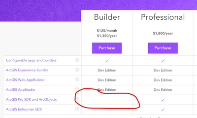

coryeicher
Hi Emiliano,
Thank you. It is helpful to know that running, even in debug, requires the proper license level for the Pro functionality being used.
The last part of the puzzle for me to solve is this empty square. I think the square is empty because of "ArcObjects": The "Builder" subscription excludes ArcMap, so therefore excludes ArcObjects.
From everything written, I should be able to do ArcGIS Pro SDK development with a "Builder" subscription. I can confirm this myself.

coryeicher
On my end, I was able to confirm that one can build and run an ArcGIS Pro SDK using a "Builder" license.
