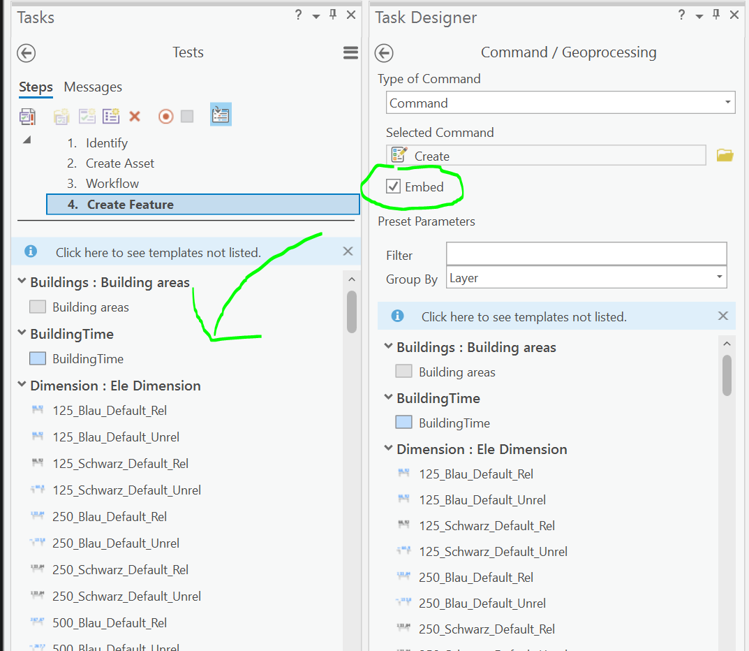

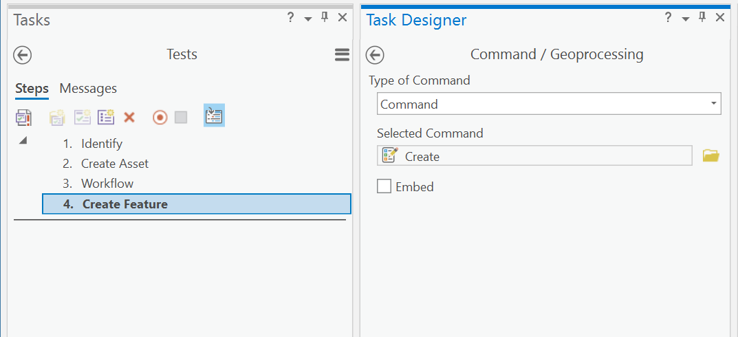

Hi,
in a step of a Pro Task it is possible for some commands that shows a dockpane, to integrate the resulting dockpane into the dialog of the task interface. For example, this works for the "Create" (show create feature pane). This is activated via the "Enabled" checkbox.
Can someone give me a hint how custom commands that display a dockpane could use this possibility? Can this be done via a configuration in config.daml? Or programmatic?
Thank you for your help
Dirk

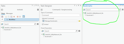

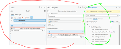

DirkTillmanns
I found an approach myself, but the view of my dockpane doesn't look really good.😂
