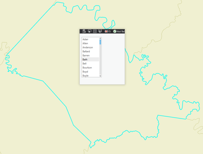

I am trying to zoom to a selected feature on a feature layer. I have found some answers here but I was not able to adapt any of them into my situation.

I think I have syntax problem somewhere. If I remove qf I am able to select everything.

The idea was zooming to selected feature when user selects it via a listbox. I knew I was doing something wrong with the whereclause so it worked when I changed the code as
string selectedCounty = CountiesListBox.SelectedItem.ToString();
QueuedTask.Run(() =>
   FeatureLayer featLayer = countiesLayer as FeatureLayer;
   QueryFilter qf = new QueryFilter { WhereClause = $@"myFieldName =
                                    '{selectedCounty}'" };
   qf.WhereClause = selectedCounty;
   featLayer.Select(qf);
   MapView.Active.ZoomToSelected();
Thanks @Anonymous User
