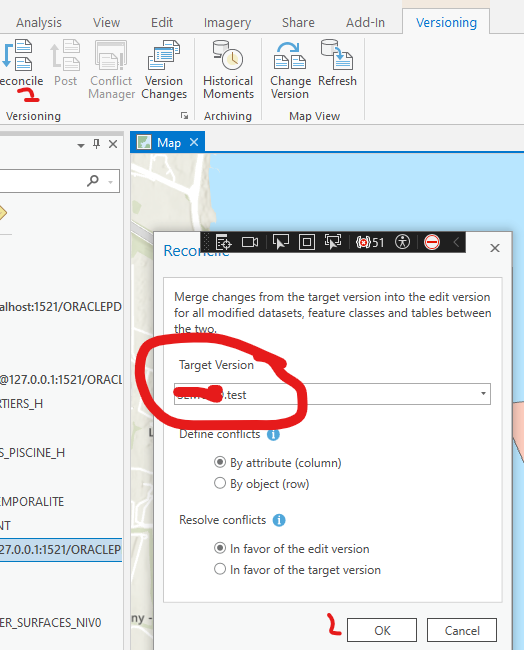

I'm using EditCompletedEvent to capture the reconcile event and to identify the changes (differences) that happened.
I would like to know how to retrieve the target version of the reconcile. Or how to replace the Reconcile popup with another one.
I want to avoid to reconcile in Default since there is a lot of users and it is a very slow process.
default => departmentA => service1 => userAlpha
default => departmentA => service2 => userAlpha
default => departmentB => service1 => userAlpha
The ideal, version userAlpha should be reconcile to "service" level only.
