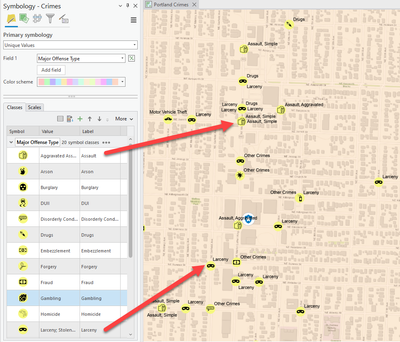

Not sure if you are aware of this, but you can do this with out-of-box ArcGIS Pro features.   You can create your own symbols (from images) as described here:  Create or modify symbol images—ArcGIS Pro | Documentation
Then you can enable the 'Unique Values' renderer to display the images using an attribute in your shapefile or geodatabase.  To display any text (text from an attribute column) you can turn on labelling for that column.   I used the community sample data: "Interacting with Maps.aprx" for the screenshot below:
ChrisNightingale
Ahh that's probably just what I'm looking for as we do need to have variants of the symbols based on data in the geo database.  Thanks so much.
