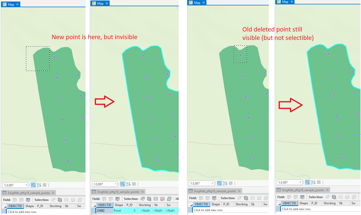

I'm working with a basic polygon and point feature class in the same FGDB in the most recent ArcPro 2.2.
Each polygon contains points in a grid, but for some reason when I delete points and recreate them I can't see the changes. The changes ARE being applied to the featureclass, but it will not visually update. I can even select the points where they've been created (but invisible).
Refreshing the map with F5 doesn't help, nor does clearing the cache in the point layer. I'm also using MapView.Active.Redraw(true); but again no luck. surely there's a way of force updating the layer?
Layer not being refreshed

I am super late to this conversation, but was struggling with the same issue at Pro 3.2.2. Adding this comment here for any future viewers who may need help with this also.
The MapView.Active.Redraw(true) fails to update my feature layer's renderer within the map. After some digging around, I found this. I tried the mentioned workaround where I simply re-set the feature layer's data connection back to itself, and my feature layers are now properly redrawing as I would expect.
featureLayer.SetDataConnection((CIMStandardDataConnection)featureLayer.GetDataConnection());
.Redraw() appears to be updating the attribute table correctly, just not the renderer. I'm not sure why that is the case, but using .SetDataConnection() method in tandem with .GetDataConnection() is performing both successfully.
Stefan_Offermann
Thanks for the workaround, this bug is still occurring with Pro 3.3.2 on my machine. You saved my weekend 🙂
