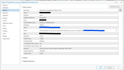

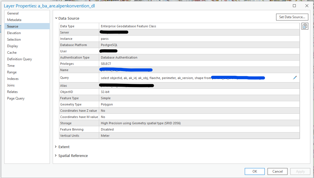

I'd like to incorporate this manual workflow into my dockpane,  but I don't find any useful documentation or samples. Does anyone know if it is possible and if yes, how it can be done?
my manual workflow:
I open an enterprise geodatabase feature class in a map in ArcGIS Pro. Then I open layer properties and go to source. there is the field "Query" (not definition query!) containing something like this "select attribute 1, attribute 2, ..., attribute n FROM layername".
I then click on the pen on the right hand side and modify the query to "select * from layername".

nadja
Thank you, that code snippet works, but unfortunately it creates a definition query, whereas I meant the query under layer properties >> source >> query...
