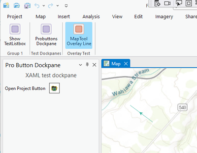

Stephen, you can also use a pre-defined arrow symbol using this code:
if (_lineSymbol == null)
  //Get all styles in the project
  var styleProjectItem2D = Project.Current.GetItems<StyleProjectItem>().FirstOrDefault(s => s.Name == "ArcGIS 2D");
  await QueuedTask.Run(() =>
    //Get a specific project style by name
    var arrowLineSymbol = styleProjectItem2D.SearchSymbols(StyleItemType.LineSymbol, "Arrow Line 2 (Mid)")[0];
    if (arrowLineSymbol == null) return;
    _lineSymbol = arrowLineSymbol.Symbol;
The example symbology will look like this:
I attached a sample tool code snippet that shows the symbology using a graphic overlay.
EDIT: please substitute the SearchSymbol string using the following to get an arrow at the end:
styleProjectItem2D.SearchSymbols(StyleItemType.LineSymbol, "Bold Arrow 2")[0];
StephenCochrane
Thanks a lot, Wolf.
It worked super.
