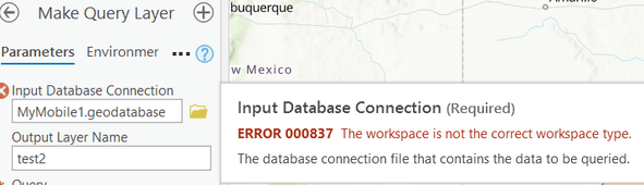

Hi -
Why can't I use a .geodatabase file as a database connection?
Thanks, Kirk

Hi Kirk,
The .geodatabase file type is a SQLite geodatabase used for runtime applications, such as Collector for ArcGIS. The Make Query Layer geoprocessing tool is looking for a .sde database connection file, such as the one generated from the Create Database Connection geoprocessing tool.

Kirk,
I found that to make ArcMap/ArcGIS Pro recognize a .geodatabase file as SQLite, make a copy and rename the extension to .sqlite.  Also, you will need to remove/rename the the "GDB_Items" and "GDB_Version" tables.
Of course, this works for "read-only" workflows and probably not recommended for inserting/updating features within the views.
