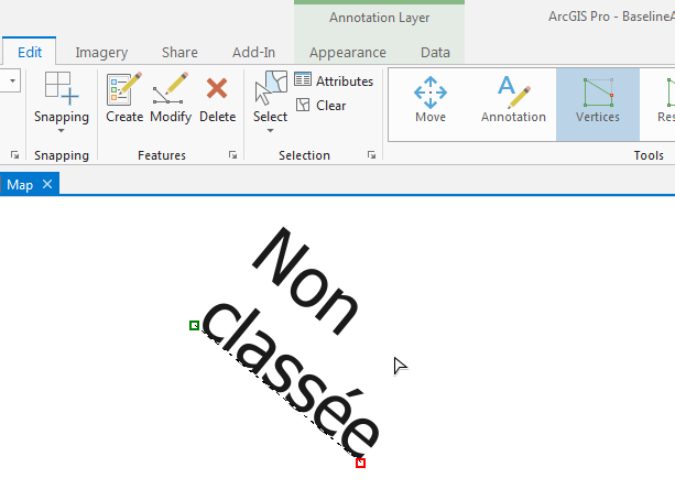

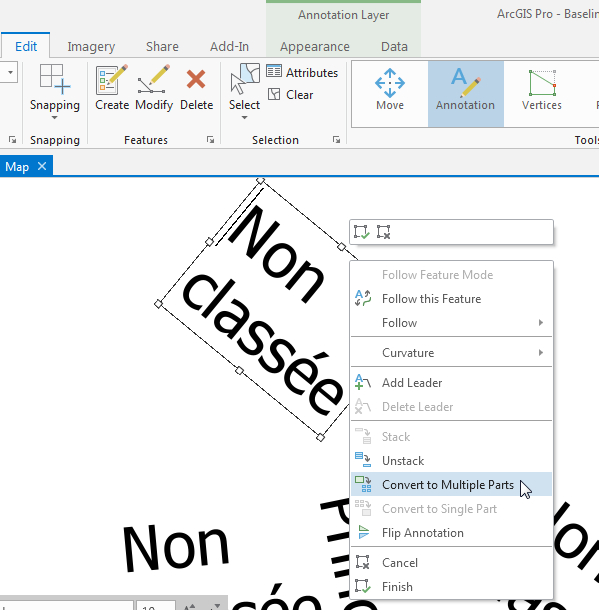

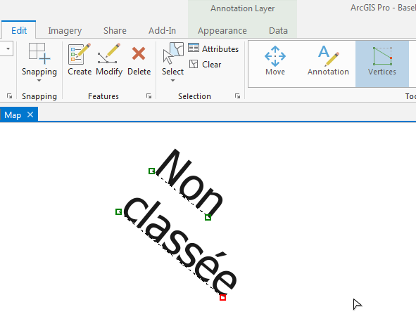

I need to implement the ArcGIS Pro annotations' feature "Convert to Multiple Parts" (see Image #2) in my code C#, but I didn't find how to do it using the ArcGIS Pro SDK for .NET, I don't even know if it's possible. So, does anybody know if it can be achievable through the Pro SDK? And if it's the case, how?

I found only one possibility how to do it- call esri command:
    IPlugInWrapper wrapper = FrameworkApplication.GetPlugInWrapper("esri_editing_annotationConvertToMultiPartButton");
    var command = wrapper as ICommand;
    if ((command != null) && command.CanExecute(null))
        command.Execute(null);
