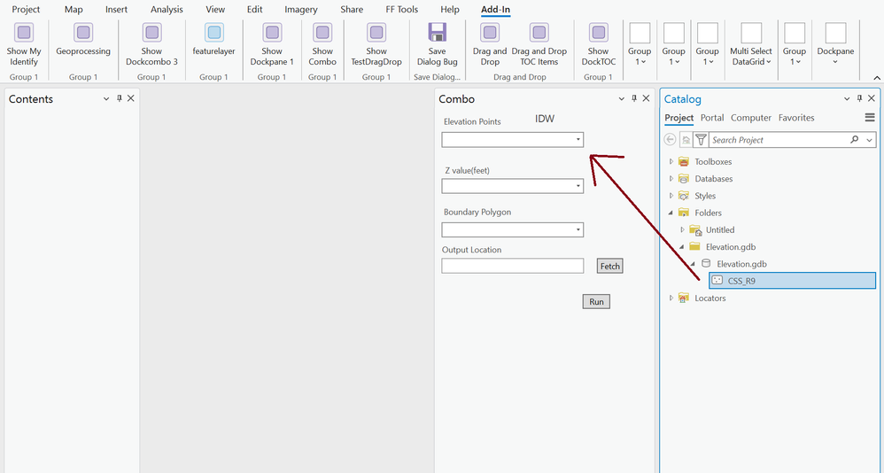

Hope you are doing well.
I am trying to Drag a feature class from the Catalog pane and trying to drop into a combo box using drag and drop functionality. However, I tried tweaking the sample https://github.com/Esri/arcgis-pro-sdk/wiki/ProConcepts-Framework#dropping-on-a-pane  for my goal but I didn't helped.
I am able to get the path of the feature class. but I don't know how I can proceed further to populate it as feature class. I have attached the screenshot of my goal.

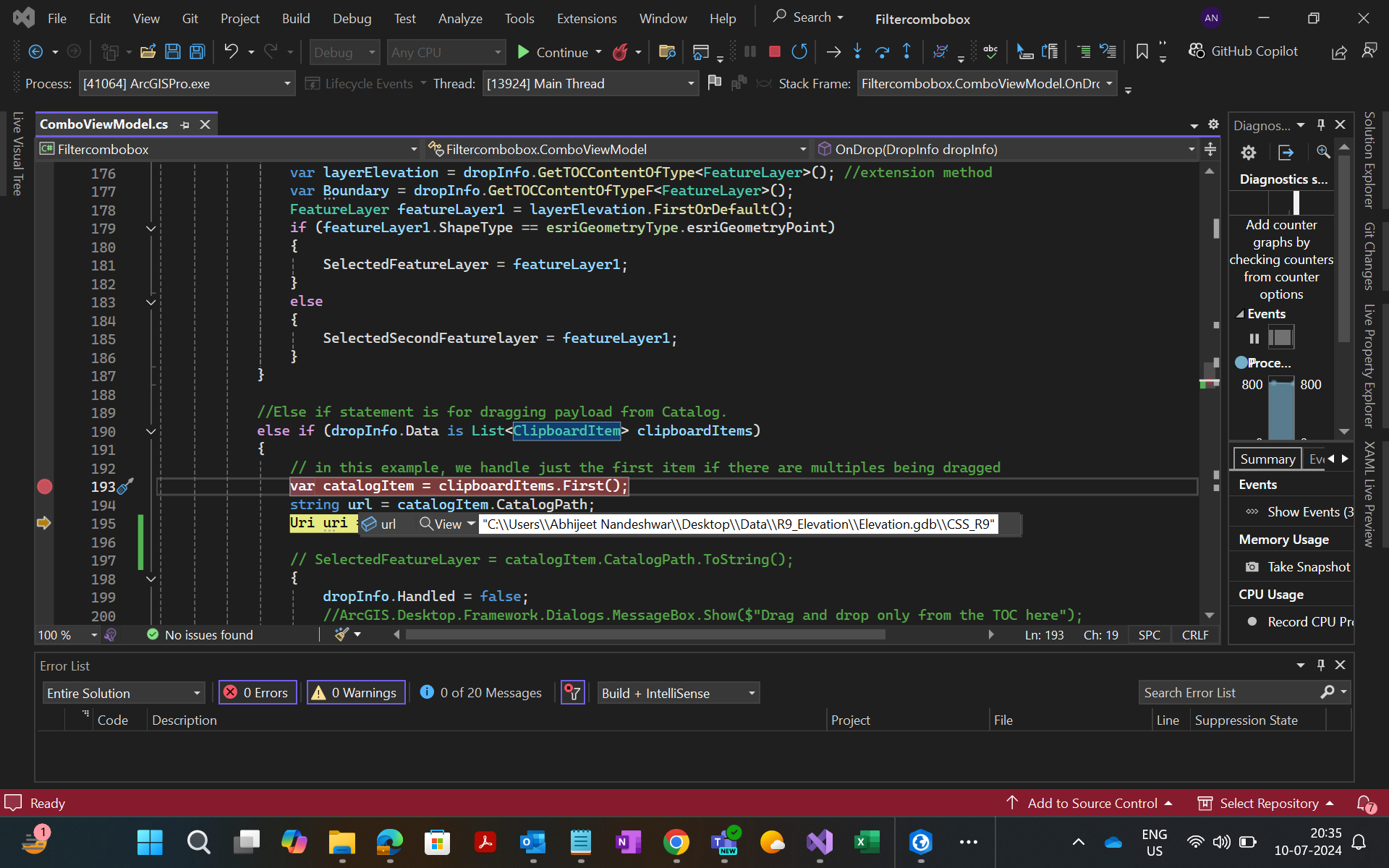

 else if (dropInfo.Data is List<ClipboardItem> clipboardItems)
     // in this example, we handle just the first item if there are multiples being dragged
     var catalogItem = clipboardItems.First();
     string url = catalogItem.CatalogPath;
     Uri uri = new Uri(url);
     // SelectedFeatureLayer = catalogItem.CatalogPath.ToString();
         dropInfo.Handled = false;
         //ArcGIS.Desktop.Framework.Dialogs.MessageBox.Show($"Drag and drop only from the TOC here");
         return;

My goal is to populate the feature class into the combo box. The sample you sent is giving me the path of the feature class.
let me frame the questions, How can I convert the URL to feature layer or feature class? However I tried converting the URL to feature layer. It's forcing me to add the layer to active map which I don't want to.

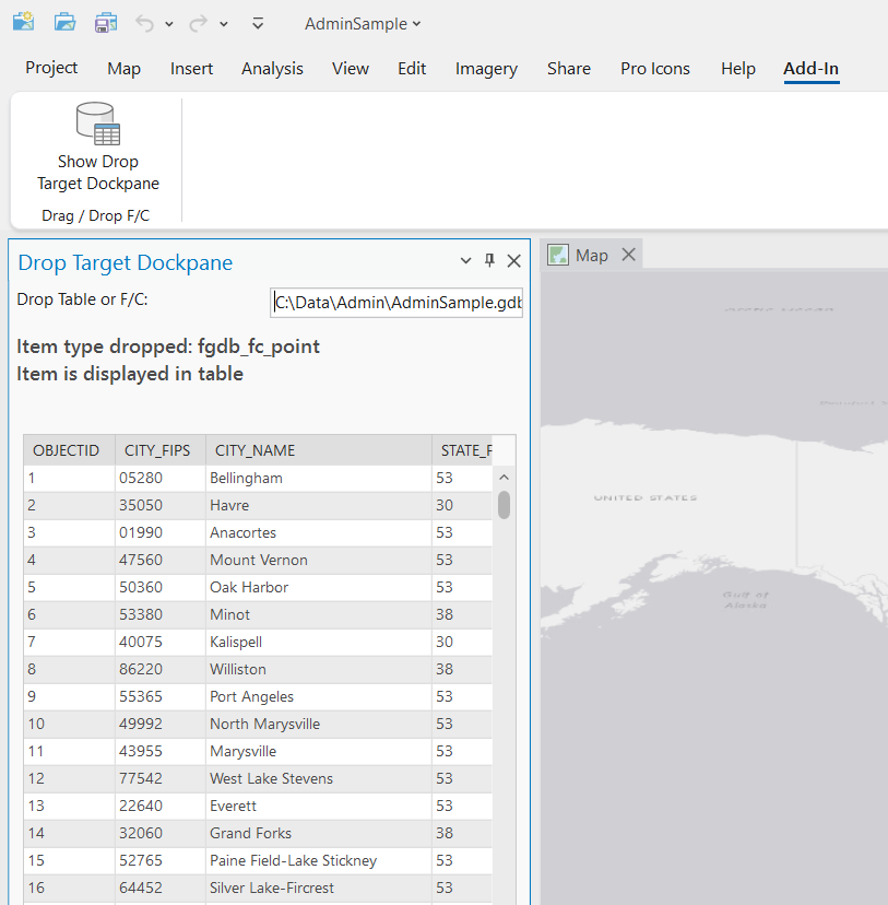

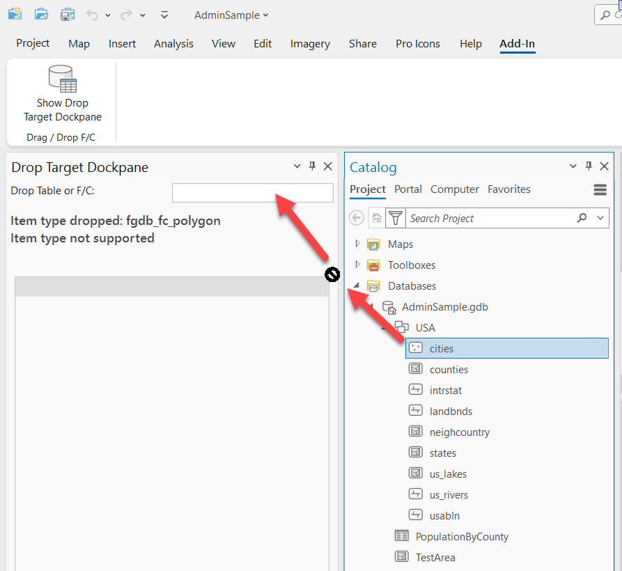

If you drag an 'Item' from the Catalog pane (specifically a Geodatabase item) you will have a Feature Class or a Table.  Feature Layers are part of the map, so you can't have a feature layer without adding a feature class to the map first.  However, you can perform operations on Feature Classes as well as Tables.   I attached a drag/drop sample the takes a dropped feature class (point) or table and displays it's content.  The sample requires 3.3
Dragging a Point feature classDragging a Point feature classShowing the dropped contentShowing the dropped content
