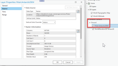

Wolf
by Esri Regular Contributor
I used the following code snippet to add an ImageServiceLayer with a 'Source Type' of 'Elevation' to my Ground Elevation group:
I used this code snippet:
protected override async void OnClick()
  var map = MapView.Active?.Map;
  if (map == null) return;
  try
    await QueuedTask.Run(() =>
      //Define a ServiceConnection to use for the new Elevation surface
      var serverConnection = new CIMInternetServerConnection
        Anonymous = true,
        HideUserProperty = true,
        URL = "https://elevation2.arcgis.com/arcgis/services"
      CIMAGSServiceConnection serviceConnection = new CIMAGSServiceConnection
        ObjectName = "Antarctic DEM: Hillshade Multidirectional",
        ObjectType = "ImageServer",
        URL = "https://elevation2.arcgis.com/arcgis/services/Polar/AntarcticDEM/ImageServer",
        ServerConnection = serverConnection
      //Add the Elevation Surface to the Ground Elevation surface [Group]
      var elevationLyrCreationParams = new ElevationLayerCreationParams(serviceConnection);
      var groundSurface = map.GetGroundElevationSurfaceLayer();
      var elevationSurface = LayerFactory.Instance.CreateLayer<Layer>(
              elevationLyrCreationParams, groundSurface);
  catch (Exception ex)
    MessageBox.Show(ex.Message);
