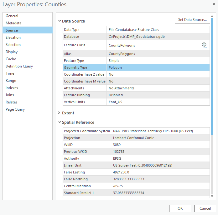

I created the layer but also I would like to retrieve layer properties such as geometry type, coord system etc.

Projection info can be accessed by
var layer_projection = active_Layer.GetSpatialReference();
 projection_name = layer_projection.Name;
For the vector type, I just search through the Shape field in the attribute table.

Cast the definition retrieved into CIMFeatureLayer. Like this:
var lyrDef = shp_layer.GetDefinition() as CIMFeatureLayer;

Ok, I did that.
Now, How can I get coordination system and the geometry type as string?
Thanks!
