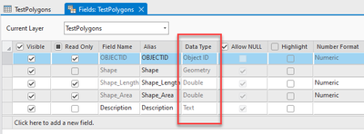

The error message "The value type is incompatible" is referring to the data type of the database column and the datatype of the OutputList variable.  Your code snippet doesn't show what types we are dealing with, but in general when you update column values in a database table (or feature class) you can only assign the appropriate matching datatype.   Take for example this table:
I have the DataTypes of Geometry, Double and Text.   So when i update those column values i can only assign a geometry (here even the geometry type point, line, polygon has to match) value, double value or a string value to those columns.  Judging by the name 'OutputList' you probably store some type of list of strings or numbers and there is no geodatabase column datatype that supports lists (or arrays).  You could store a short list as a comma separated list of strings in a text field, but you have to watch out for character limits on text fields.
