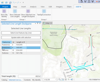

I attached a sample that is using a dockpane to show the selected [line] rows and the respective length.  Note that the length was computed using a area specific projection (in my case Hawaii), so you might want to change this to fit your needs.  When you click on a line in the grid the corresponding feature will flash on the map.
