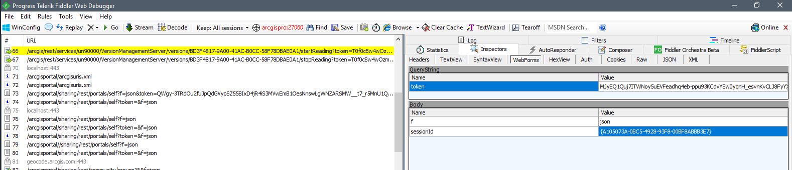

I am trying to use "Apply edits" feature service from my ArcGIS Pro Add-in.  See link.  Since I am working in a long transaction inside a branched version, I need the "sessionID" parameter when  POSTing to ArcGIS Server.  How do I retrieve this from the ArcGIS Pro SDK? See my feeble attempt below
I know that normally the client provides the GUID for the sessionID to ensure isolation, however it seems that ArcGIS Pro generates its own sessionID at startup (see screenshot below code snippet), and I would like to use that value for my service calls within the Pro client.
