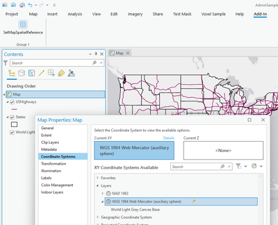

I am not sure what you mean with dataframe, but this is what my code snippet does:
Before running the code snippet, my Map is using the NAD 1983 spatial reference
After i run my code snippet that Spatial Reference changed to Web Mercator
