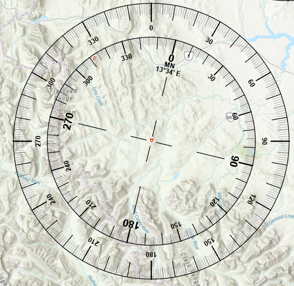

Hello,  I attached a screen shot for your reference.  I started off with a dockpane and the combobox and checkbox combination works.  I have a variable that is set when the user selects a point layer from the combobox.  The variable is true/false as to whether the selected layer contains selected features.  The checkbox uses databinding and connects its IsChecked setting to the variable.  This works.  Now as I have been developing this tool I  decided that perhaps all the users settings that appear in the dockpane should be on a properties page instead.  Now if i move all my properties off the dockpane, there isn't much left so I moved the combobox and two checkboxes along with the run button to the ribbon.  I just can't get the checkboxes to change when the combobox item is changed.
This is what the tool creates
