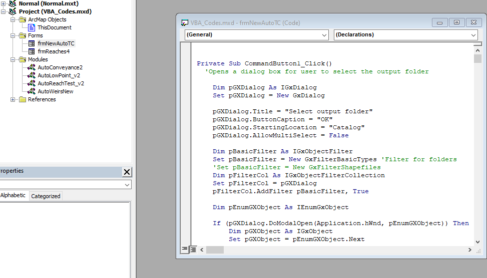

I want to copy this code for a tool that runs like a geo-processing tool for water flow.
I'm moving from ArcMap VBA Editor to Pro SDK from MS Visual Studio using ArcGIS Pro based on these ESRI articles:
ArcGIS Desktop and VBA Moving Forward (esri.com)

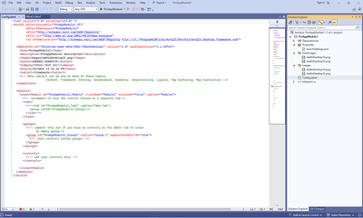

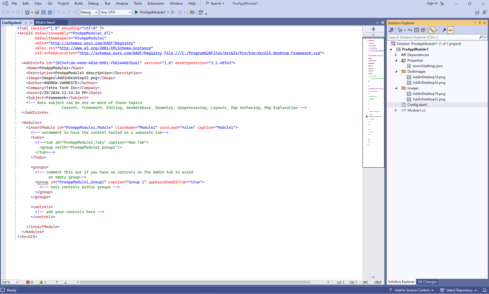

I'm a little unsure how to do this. I have some screen shots of the code and my progress. Thank you!

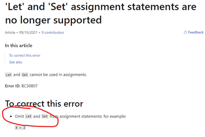

Thanks a lot for your help Carlos. I got a lot of errors about "Set" and "Let" not being valid. Online I see to omit it but it seems like that could cause more errors:
