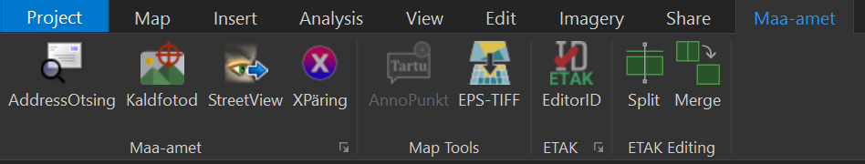

I have made several add-ins that I have placed in custom tab and groups:
In order to achieve this I have written cross-references in each config.daml file, so that each add-in could be used / installed alone, as well with others, but this makes code quite confusing and not easy to manage because every time a new add-in is created, I should update all other add-ins' config.daml files as well that belong to the same group. Is there any better solution for this?
One, that I can think of, would be to use one add-in as compulsory to install and describe all other add-ins in that compulsory config.daml file (?), but it's not the best solution because I want that users can choose which add-ins they want to use.

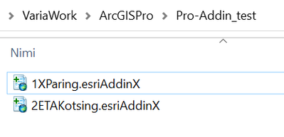

Hi again!
I tested now the solution by GintautasKmieliauskas and unfortunately it's still not the best solution for me, because I found out that it's not the order of making add-ins and defining dependencies in their configuration files, but the order (alphabetical) of add-ins in folder from which they are loaded that matters. E.g. if add-in B has no reference to add-in A and add-in A has reference (dependency and updateModule defined) to add-in B, B still will not load in custom tab and group (although, yes, I can see it in Pro's add-in manager list).
Then again if I rename them e.g B -> 1B and A ->2A, they both load correctly.
So, the only solution to this would be still to use many cross-references or rename all add-ins that follow previously made ones alphabetically descending?
Thanks!

kirken
No, it's not the case, insert="after" shold be default value, I read from doc, and it's fine by me. I just don't get it. E.g. I've got two add-ins: 1. XParing (has no dependencies, created first) 2. ETAKotsing (has dependency on XParing and has to wait for Xparing to load first) like I have defined in ETAKotsing config:

but the result is that only ETAKotsing appears in MA_MainTab:
Then again, if I just change the alphabetical order in add-in loading folder:
I get the result that I want:
So, it seems that I'm missing something and defining ETAKotsing dependency on XParing is not working as Xpaing is not loaded first (unless they are in a correct alphabetical order in add-ins folder, which has to be their making order) .

kirken
Ok thanks! I got something working and I got the idea how it should work (although not all combinations seem to work correctly but hopefully I'll figure out).
