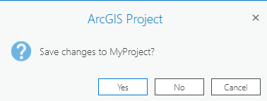

Hi,
when ArcGIS Pro is closed by the user and there are pending changes like camera pan or whatever, the user is presented with the question whether the changes shall be saved:CloseProject.png
I need to know whether the user clicked Yes or No because depending on what was clicked, I need to commit/rollback a transaction in an external SQL database. I looked around and found some events like ProjectSavingEvent etc. but that doesn't quite do it for me. Is there something I missed in the SDK or is the functionality I need simply not present?

Okay, I figured it out.. one needs to subscribe to ProjectClosingEvent, ProjectSavingEvent, ProjectCloseCanceledEvent and ProjectClosedEvent
If project closing starts and afterwards the ProjectSavingEvent fires, the user chose to save the changes. If the ProjectCloseCanceledEvent fires, he chose to cancel the changes and if no event fires between ProjectClosingEvent and ProjectCloseEvent then the user didn't save the changes. This works but come on, I wonder why there is no specialized event just for that...

RehmSoftware
Hi,
thanks for your reply but the ProjectClosingEvent fires BEFORE ArcGIS Pro displays the MessageBox I mentioned above so obviously I can't know what the user clicked eventually from that event handler..
As I said, I looked through the events but couldn't find one that suits my needs.. I'm starting to believe that ArcGIS simply doesn't provide any means to get the info I need, but maybe you or somebody else has another idea..
