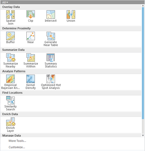

Hi,
I am trying to create a new inline gallery items...Could anyone help me with an example to create a Custom Inline Gallery with Custom Gallery Items.#arcgisprosdk

But My issue is I would like to create the items in the Inline Gallery with categories as similar to this.

You can accomplish this by setting the Group property of GalleryItem. In the config.daml where you define the gallery element, set the "showGroup" attribute to "true".  Like this:
 <galleries>
    <gallery id="GalleryDemo_WebMapsGallery" showGroup="true" caption="Web Maps Gallery" className="WebMapsGallery" itemsInRow="5" dataTemplateFile="pack://application:,,,/GalleryDemo;component//WebMapsGalleryTemplate.xaml" templateID="WebMapsGalleryItemTemplate" resizable="true" largeImage="Images\GenericButtonOrange32.png" keytip="z3">
       <tooltip heading="Web Maps">Tooltip text<disabledText /></tooltip>
    </gallery>
 </galleries>‍‍‍‍‍
