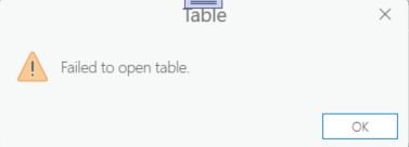

@CharlesMacleod Ya I am deleting the group layer as well as sub layers when the project is reopened again. But now I am getting another issue which is a message box with error "Failed to open the table" on project reopening. And more interestingly sometimes it comes sometimes it won't.
And I am pretty sure this is related to my layers in the memory database because whatever number of layers are present in the group layer that many times this pop is coming. But why is this so? Because memory database will get deleted when ArcGIS Pro is started again (since it will be there for that instance of Pro). And I thought that the tables will also be gone. And on project open I am also deleting the layers as well. But it seems Pro is still trying to open that table. But from where? Any idea what it can be?

@CharlesMacleod No I think deleting the in-memory layers now on Map Initialization is causing the error. Because the above logic will run when Map is initialized. But while Pro is in Initialization stage I think it will try to fetch the details of those in-memory layers and since in-memory DB is deleted, it will not find the data for those layers and then it is throwing an error "Failed to Open the table". Therefore, I don't think deleting those layers in Initialization is a good option. But I don't know what will be the other best option since On closing Map View is null.
