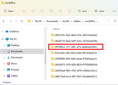

Hi,
If you know old add-ins GUID's you can remove their folders from This PC > Documents > ArcGIS > AddIns > ArcGISPro folder.
  <AddInInfo id="{997969c2-c517-4481-af7e-dbdb0e20399c}" version="1.0" desktopVersion="2.0.0">

I know the GUIDs. However, that does not sound like this is something I can build into to installation routine of the new Add-In.
I am looking for some functionality similar to dependencies of one Add-In to another Add-In, or using the DAML to remove buttons in the UI... just to delete a whole Add-In.
