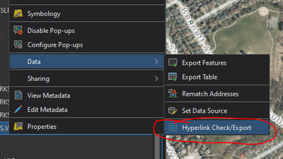

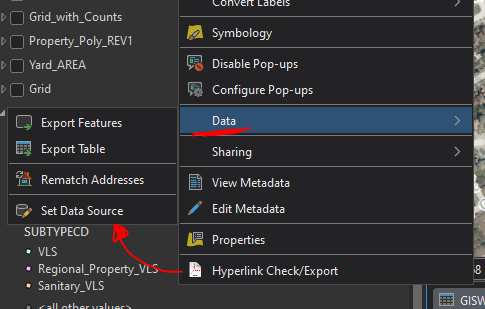

I'm trying to figure out how to add a new menu item to the "Data" menu when right clicking on a layer in the TOC.
The code below will add it to the layers context menu, but doesn't place it into the correct location.  I can't seem to find an ID for the "Data" menu.  I want my new item to appear under "Set Data Source".

BrianBulla
Honored Contributor
Thanks Narelle...
That works perfectly!
	  <updateModule refID="esri_editing_EditingModule">
		  <menus>
			  <updateMenu refID="esri_editing_data">
				  <insertButton refID="Hyperlink_Button" placeWith="esri_mapping_SetDataSourceContextMenuItem" separator="true"/>
			  </updateMenu>
		  </menus>
	  </updateModule>
