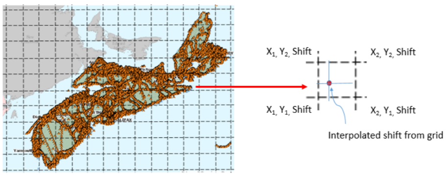

Perhaps horizontal grid shift geotransformation could achieve the same results as rubbersheeting.
A grid shift file facilitates the conversion from one coordinate system to another. A grid shift file is often used for defining a transformation over a large area when the distortion in one of the coordinate systems inhibits the use of an exact set of transformation parameters. One of the first grid shift files used in Canada is the National Transformation version 2 (NTv2) which performs coordinate transformations from NAD27 (high distortion) to NAD83. Since NTv2 was developed, other grid shift files have been created using the same format.
NSCRS Technical Support 0009 Grid Shift Files 3Feb2016.pdf
The hard part is creating the gsb file.  The file format isn't well documented.  Proj.org says:
Details about all three formats can be found in the GDAL documentation and/or driver source code. GDAL reads and writes all three formats. Using GDAL for construction of new grids is recommended.
I don't see anything relevant to gsb in the GDAL docs search results though.
Esri's ntv2_file program might be better.  Esri support has a document describing how to install the gsb file for Desktop. It doesn't mention Pro, but I suspect it's just a matter of copying it here:
C:\Program Files\ArcGIS\Pro\Resources\pedata\ntv2
Or ... it might just be easier to learn to live with link layers in your map.
