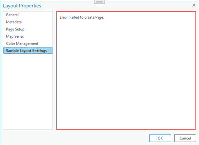

I made some progess:
    <propertySheets>
      <updateSheet refID="esri_layouts_propertySheet">
        <insertPage  id="esri_sdk_PropertyPageLayoutSettings"
						caption="Sample Layout Settings"
						className="LayoutSettingsViewModel">
							<content className="ProjectSettingsView" />
			</insertPage>
      </updateSheet>
    </propertySheets>
I will keep this thread updated, perhaps someone else will find it useful.

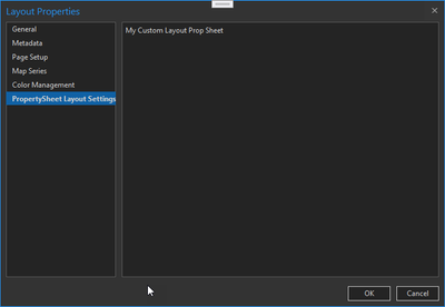

Wolf
by Esri Regular Contributor
I attached my sample
To implement the sample i added a property sheet (via New Project Item template) and then used you updateSheet daml above to show the property sheet (that i created) under the layout properties dialog .  I didn't delete the auto-inserted propertysheet daml yet (for illustration).
Note:
in the config.daml of the sample please check the desktopVersion="2.9...." attribute for the AddInInfo tag.  Make sure to set it to the version of ArcGIS Pro that you are running: i.e. 2.7.0, 2.6.0 .... Otherwise the sample won't work for you.
