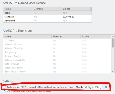

@AmnoyAm So, I think I may not have explained it well in my initial question. But, regardless if you're using Concurrent Licenses or Named Users, you have the option to "Authorize ArcGIS Pro to work offline without Internet connection" (See image below). Once this is checked, the user's User Name license goes into a "disconnected" state in AGOL. In my case, I'm working on an application for updating a user's User Type (CreatorUT, GISProfessionalStdUT, GISProfessionalAdvUT) on the fly without needing admin intervention. But, if the user is "disconnected" I can't change the user type, so I was wondering if the ArcGISPro SDK had a way to exit the offline mode. It's performed by the user in ArcGIS Pro, so I just thought it probably is somewhere, but I may just be looking in the wrong place.

Concerning offline licenses, the short answer is "NO".  When taking licenses offline, you're basically moving the licenses to the local machine.  This is why users can start Pro on or off the network. Any attempt to modify it will cause a offline license to become invalid.  In addition, the user will not be able to return the offline license back to the license portal if it had been tampered with.  As a matter a fact, the application is designed to prevent any licensing change after taking a NU offline.  You cannot change to any other license type until the offline license has been returned.  Also as I explain in the previous response, NU licenses are assigned to the user at the portal level.  You cannot make a UT or add-in extension change from Pro.

@AmnoyAm So, there's no "tampering" happening. I have a backend API that's handling all the requests and is using the ArcGIS API for Python and the ArcGIS Online REST API for handling User Type / extension assignment or for getting current organizational states. I will be allowing users to select which UT/extensions (if necessary) they need in Pro, which would then make the request to the API to update their user type in AGOL. So, I don't need to alter their offline license. What I would like to do is be able to check back in the license to AGOL so that I can update their UT if they wanted to update it, and then possibly take the license offline again. I mean, I can always tell the user their license is disconnected and they need to return it before they can update it, but it would be nice to be able to bypass that.

Unfortunately, the answer is no.  There is no exposed API call to return an offline named user license.  We don't let any licensing related settings change for a user while they are offline because those changes cannot be propagated to the user until they sign back in again.
Perhaps you can post the suggestion in the ArcGIS Ideas section for future consideration.
