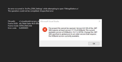

Hi,
I'm getting the following error when I try to open some ArcPro .NET projects.  I've never had problems opening them in Visual Studio before.  Would Windows updates be the cause of this??

I think you need to update Visual Studio. MSBuild 17.0 shipped with Visual Studio 2022.
What SDK version are you using? The 3.3 requires .NET 8.
