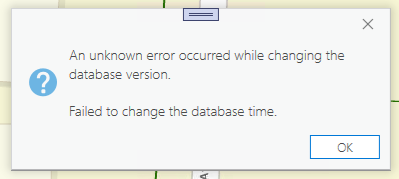

What I also would like to do is use the ‘Specific Date and Time (UTC)’ functionality with a Feature Service Feature Class data source and I was also wondering if that was exposed in the ArcGIS Pro 3.1 SDK as well. I am currently attempting to use the logic below to select a specific date/time, but it appears ChangeVersion is handling an exception and displaying the attached error image.
Does the ArcGIS Pro 3.1 SDK support changing the map version to a specific date and time while connected to a Feature Service Feature Class data source?

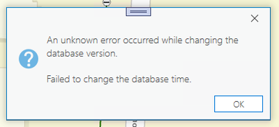

When calling MapView.Active.Map.ChangeVersion(fromVersion, historicalVersion), the map seems to handle an error with a message 'An unknown error occurred while changing the database version. Failed to change the database time.'
The SDK seems to be hiding an error with my code or something with the underlying feature service database.
Do you know where I can find more information about this condition when attempting to change to a historic version using a feature service?
Using the Change Moment (History) pane in ArcGIS Pro 3.1, changing to a Specific Date and Time works correctly with the same project.
Thanks again, Jon
