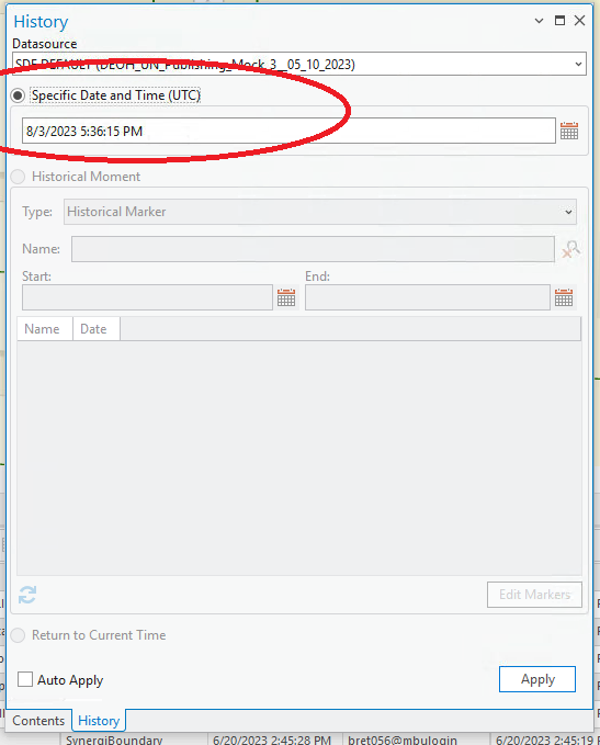

I am attempting to add functionality to a custom ArcGIS Pro 3.1 add-in to set a specific date and time and apply the time as a historical moment. With the feature service data source that I am using, I am able the do this manually by selecting the data source, selecting Change Moment, entering the specific date & time, and then selecting the apply button.
I would like to create behavior within the add-in to do the same thing using the ArcGIS Pro SDK. Does the SDK support changing the map version to a specific date and time?
Also, the Historical Markers option on the History pane is disabled. I am assuming it is disable because it is not supported while using a feature service, but I cannot find documentation if this is correct or not. Can someone point me to documentation about the History pane the Historical Moments requirements?
I would appreciate any help, Jon

What I also would like to do is use the ‘Specific Date and Time (UTC)’ functionality with a Feature Service Feature Class data source and I was also wondering if that was exposed in the ArcGIS Pro 3.1 SDK as well. I am currently attempting to use the logic below to select a specific date/time, but it appears ChangeVersion is handling an exception and displaying the attached error image.

Using the Change Moment (History) pane in ArcGIS Pro 3.1, changing to a Specific Date and Time works correctly with the same project.
