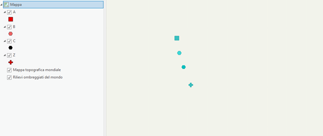

Hello everybody, is it possible to understand in which order the editing events are triggered on a group of edited Featureclasses \ Table ? In this example I have 4 featureclasses called A,B,C and Z.
To register the change events I used the following code (taking the layers in toc order).

I take a group of features belonging to A,B,C and Z and move them (using the move tool). The return order of the modified features does not follow the registration, but it would appear to be a random order ( in this case Z,C,B,A). How is the return order of these events defined?

I tried with objectid. The 4 Featureclasses have 5 objects in total
A -> objectid 104
B -> objectid 121
C -> objectid 103
Z -> objectid 61,200
When I move 104,121,103 and 61 the order is this : Z,C,B,A
The same with : 104,121,103 and 200
I'm even more confused 😞
