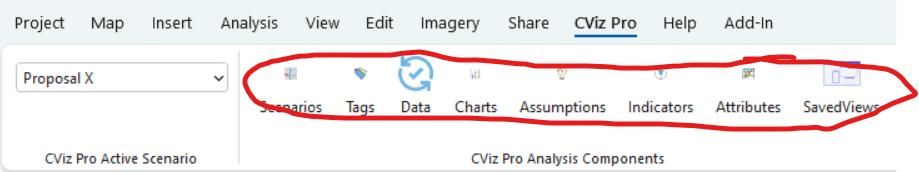

I am working on a ArcGIS Pro Addin. The ribbon was good in ArcGIS Pro 3.2. After upgrading to 3.4, some of the buttons don't load properly anymore. All of the buttons are 32px by 32px png. What could be the issue?

Part of my problem was actually caused by wrong build action of the image files.

I believe there’s an issue in 3.4 with ribbon buttons not properly stretching the image when using a small icon (16x16) in place of a requested large icon (32x32); the ImageSource doesn't stretch correctly. Can you verify your icon size?
MK13
@vanesch  The 32 by 32 buttons aren't showing up properly either. They are displaying like a 16 by 16.

I think this is still the same issue. Can you verify the png is correct, i think it has a bad scaling set.
