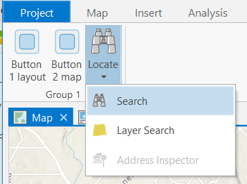

When I put this in my DAML:
I see this:
I see this:

CharlesMacleod
This is what I see in the ADMapping.daml.
<splitButton id="esri_mapping_locateSplitButton" keytip="L" extendedCaption="Search for addresses">
          <button refID="esri_mapping_showLocateDockPane"/>
          <gallery refID="esri_mapping_locateGallery"/>
        </splitButton>
So, I think if u reference the locateSplitButton rather than the showLocateDockPane u will be good to go.
BrianBulla
Honored Contributor
Thanks guys.  _locateSplitButton worked.
