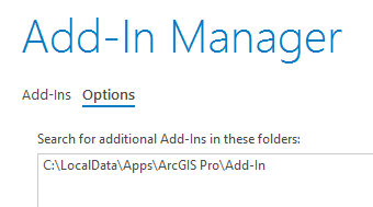

Hi there,
I have setup ArcGIS Pro V2.5 to use a local folder to load in several .esriAddinX files from the Add-In Manager option
What is the best practice/correct way to store the .esriAddinX files in this directory?
Option 1 - Is it the files straight in the directory
Option 2 - Should they be in their individual folder (eg. GUID - ID from the config.daml file) and then the file which is the same if you double-click the file and it's installed in your 'Documents' folder
The get started documentation talks about 'manually copying the file to a well-known folder'. What does it really mean by this?

Hello Anthony,
Your options 1 and 2 are equally valid approaches. The GUID folder is created when compiling your add-in, but is not required for use in any well-known folders you've designated which Pro reads at start-up. The manual copying does literally mean copying (whichever method you choose) of the .esriAddinX file to a well-known folder that you've designated via the Add-In Manager or by a registry key. At startup, Pro will then read those folder locations and load the .esriAddinX files found there.
On the second part of your question, add-ins within a given well-known folder are loaded in alphabetical order determined by their ID.  You can find further information here in the Advanced Topics document Add-In Loading section. You can learn about add-in loading and admin options for managing well-known folders, etc.
