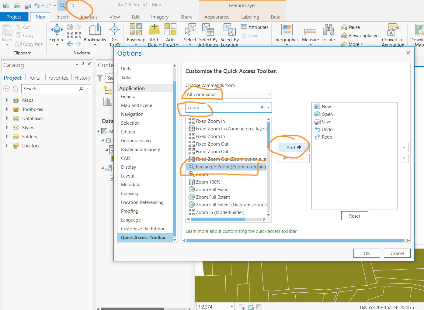

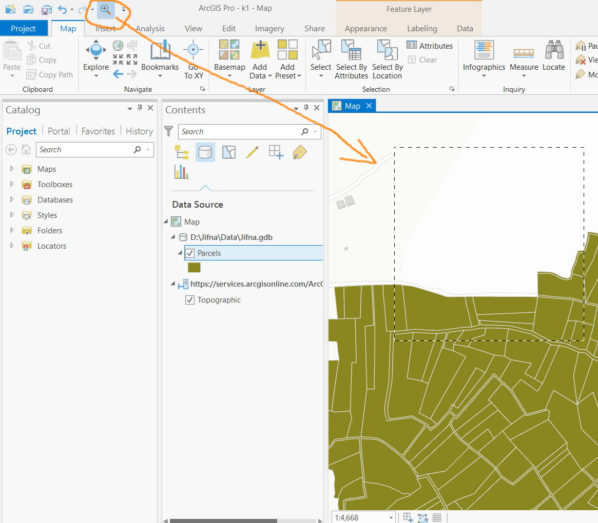

Rectangle Zoom is available in ArcGIS Pro 2.2.  It isn't included in the ribbon by default, but you can go to the backstage Options and add it to a group in a ribbon or to the Quick Access Toolbar.

Many thanks Kory for the help. It is nice that this tool is included in 2.2 version
